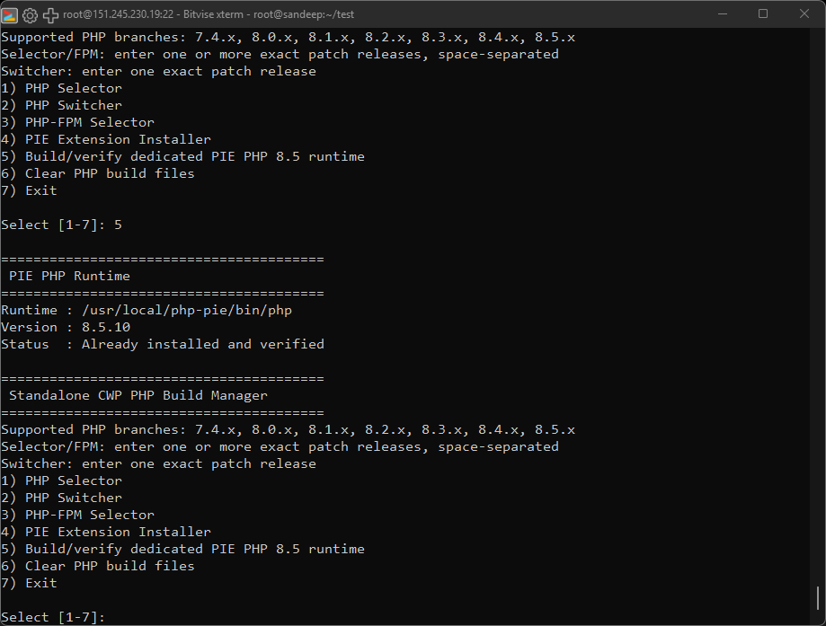

AlphaGNU Standalone CWP PHP Build Manager
Managing multiple PHP versions on CWP can sometimes be difficult, especially when dependency issues involving zlib, libzip, PCRE2, GD, or other libraries cause normal PHP builds to fail.
The AlphaGNU Standalone CLI CWP PHP Build Manager provides a simple alternative: build PHP directly from official PHP source while maintaining CWP-compatible PHP layouts.
Why use it?
If PHP installation is failing on a server because of dependency or repository problems, this manager can be used to quickly build and install the required PHP version without relying on CWP's PHP build scripts or Remi PHP packages.
It supports:
  • PHP 7.4.x through PHP 8.5.x
  • PHP Selector
  • PHP-FPM
  • PHP Switcher
  • Multiple PHP versions in one command
  • One-line CLI installation
  • PIE extension installation
  • Dedicated PHP 8.5 runtime for PIE
  • Automatic dependencies for extensions such as Redis, Memcached and Imagick

php-manager --help
Start the interactive menu:
php-manager
Build PHP Versions
PHP Selector
Build multiple versions:
php-manager selector 7.4.33 8.2.29 8.3.8 8.4.25 8.5.10

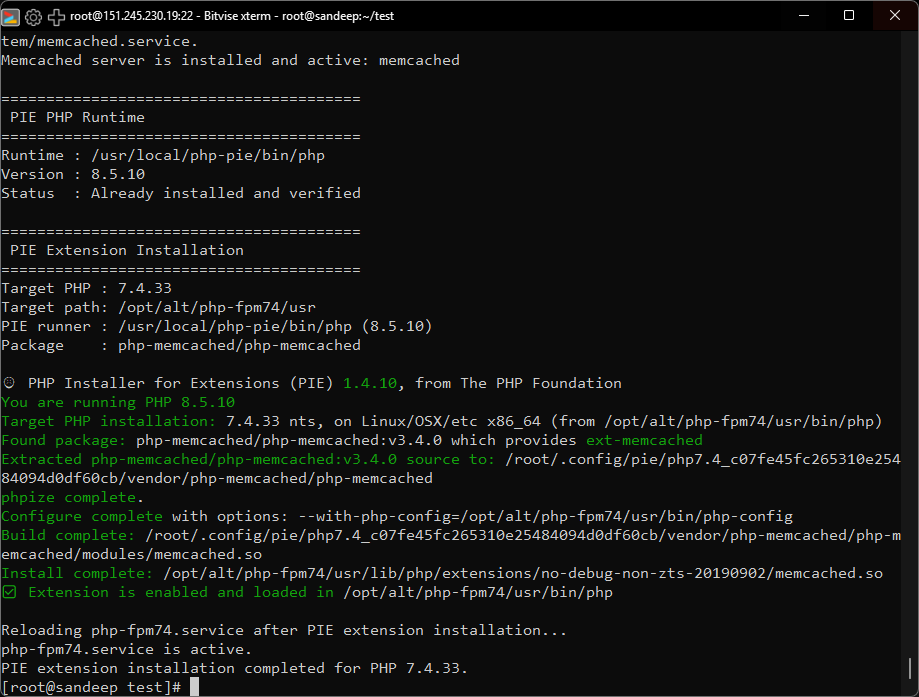

Install PHP Extensions with PIE
You can find available PHP extension package names by visiting:
https://packagist.org/extensions
Search for the extension you want to install and use its PIE package name.
Install an Extension for PHP-FPM
For example, install Memcached for PHP-FPM 7.4:
php-manager pie 7.4 php-memcached/php-memcached fpm
Redis:
php-manager pie 7.4 phpredis/phpredis fpm
Imagick:
php-manager pie 7.4 imagick/imagick fpm
APCu:
php-manager pie 7.4 apcu/apcu fpm
You can also specify the exact PHP version:
php-manager pie 7.4.33 imagick/imagick fpm
When using only the major/minor version, such as 7.4, PHP Manager automatically detects the installed PHP 7.4.x version.
